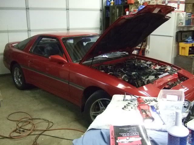

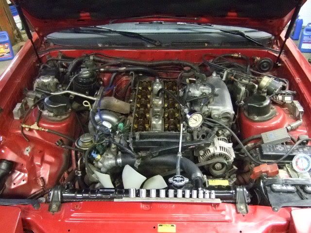

I found my self adding coolent occosionaly but didnt think much of it( or didnt want to think about it) Finally a month or two after I first noticed I ran a compression check. It came out 200,190,200,195,192,200 I was pretty happy with this. Then I ran the leak down test. Cylinder 1, 150psi and holding. 2 holding, 3 holding, 4......shit! ::bhg:: . 5 & 6 the same. Its a pretty slow leak through all 3 cylinders and I know the head was torqued to factory specs as it was a toyota crate motor, Ya big $$$ for the last owner.

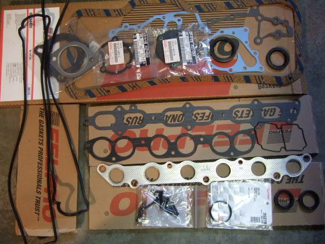

First I decided to give a retorque a shot, I think out of curiosity more than hope of any fix I would feel comfortable with. I took it to 70, just to see what if would do. Ran the leak down again; 1-still holding, 2-still holding, 3-still holding, 4-now holding, 5- still leaking but slower, 6-now holding. So it sealed 2 of the three cylinders but 5 is still leaking. its slow enough It would definatly be drivable but Im just going to go ahead and get it overwith now. So I guess I have a fall project. So my rebuild begins and with it come the questions.
1. How hard is it to get the tranny off? I really dont want to pull both like the tsrm says. On my budies swap we left it on but only because we already had a good motor and tranny ready to go
2.What gaskets would you recoment? Commetic, or HKS? what about intake, exhaust, thermostat housing, cam seals ect. Toyota is pricy and ebay is dirt cheap, both are discouraging. Are any of the ebay kits worth even looking at? What about felpro? definatly cheaper and the exhaust manifold gasket we threw in my little bros car looked pretty good?

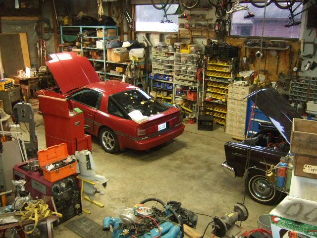

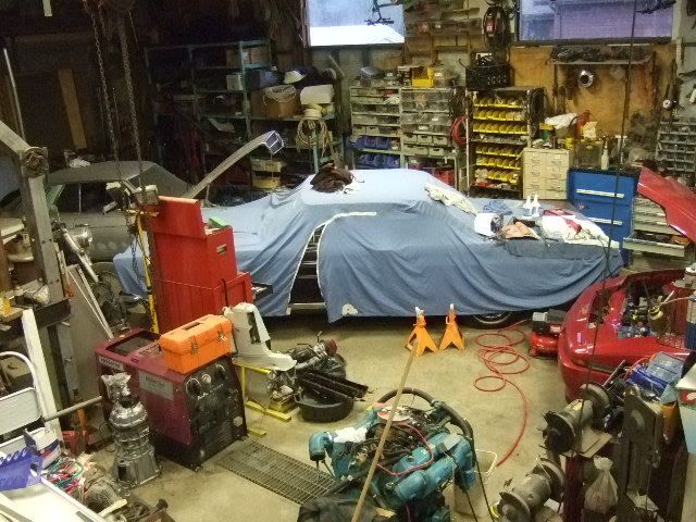

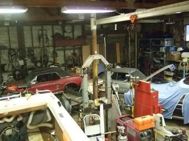

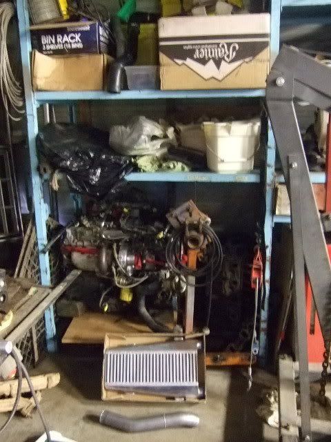

Heres a few shots of my incredibly packed shop, The worst step in this project is going to be making room. The benz in the back is definatly going OUT!
Ya thats a 67 mustang in the back ( Future project) and a 65 comet caliente under the cover. Wheres waldo, can you find the R154 in this pic

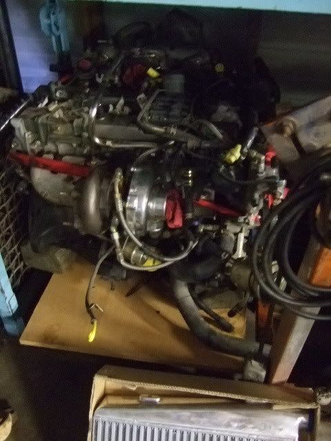

My motor as it currently sits
The parts shelf
This engine once made well over 600 ponies on the dyno, with and automatic behind it!!!
Can you tell Delilah's a little crammed at the moment

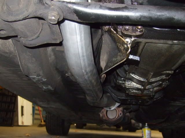

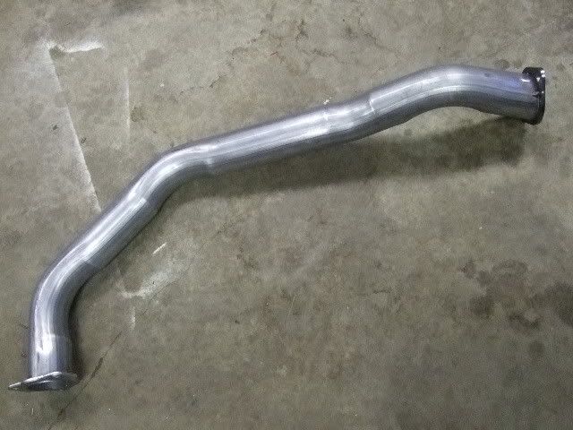

Heres the downpipe I just fabed up, at the moment the flanges are only tacked on so it could be test fitted. I also still have to splice in the flex section.

The R-154 is beside the welder. What did I win?
I'd pull the tranny with the engine and then take it apart, but that's just me. Good luck.

I agree with Suprahero, it'll be easier to pull the tranny while the motor is still attached, although I'd lift the car up a couple inches to make sure it clears. How many cars do you have? I see atleast 4, and not 1 looks to be working (2 confirmed).

Finally have a little room to breath, the worst part is you would never guess how many hours of clean up went in to this. Still Looks like a mess
My downpipe fits about as close as you could ever hope for so I was pretty satified there. Tucks up tighter than my bros RT

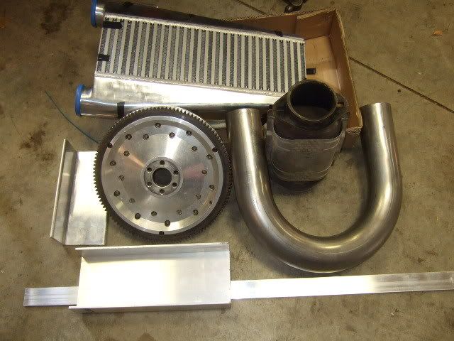

A few things came today
Some more goodies for delilah

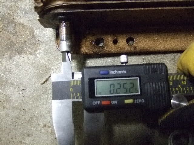

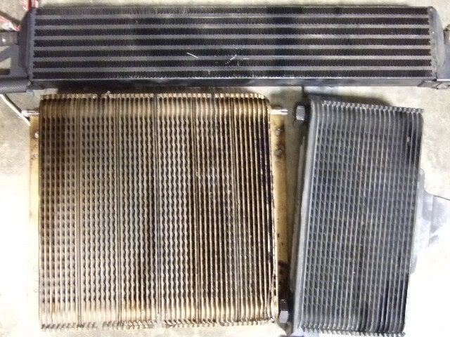

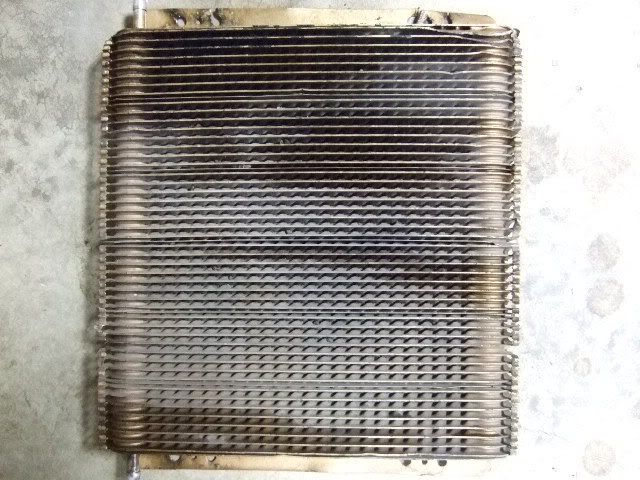

I picked up a few oil coolers at the wrecking yard today. The large one is Idendical to a B&M stacked plate cooler and measures 11X11
which should barely fit with my new intercooler location.

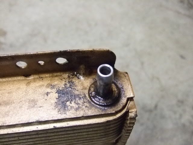

This is the only issue with it
The ports are quite a bit smaller than the 1/2 inch lines I will be running but the cooling capacity should be more than enough.
Im debating on wether I can just live with this as it saves me $70. Or will it cause problems having ports that small???
Any input would be greatly appreciated here. Good enough or spring for the B&M ...66 8.5X11 cooler???

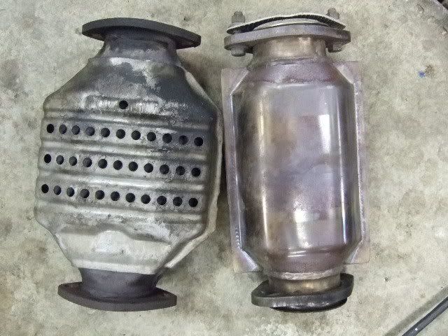

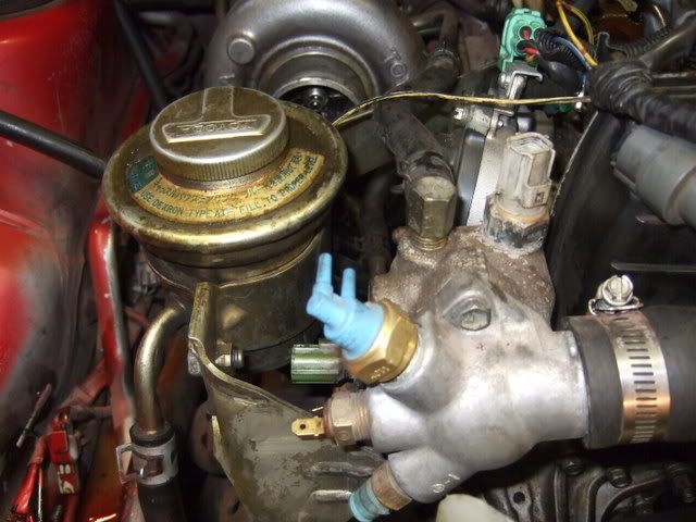

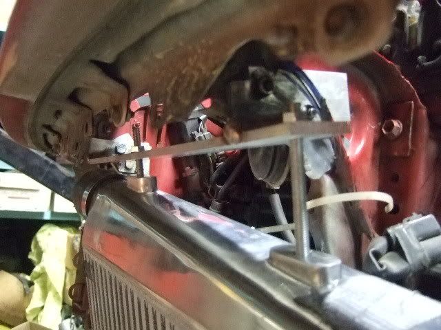

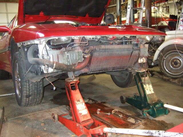

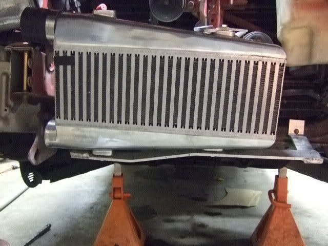

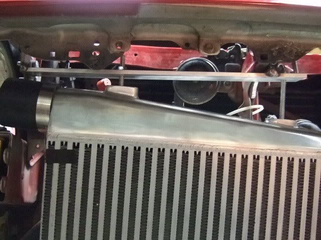

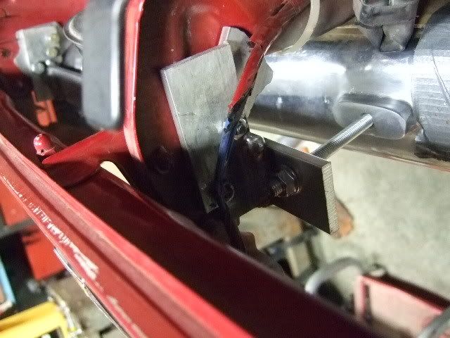

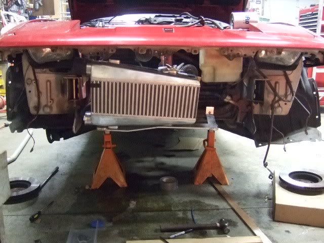

I finally have my intercooler in place, haven had much time to work on it and when I have it seems like everything takes twice as long as I inticipate. I just have to drill a few more holes in the top mount. Then its on the the bumper support and designing new IC pipes.
The cat stock cat is getting replaced with an RT one

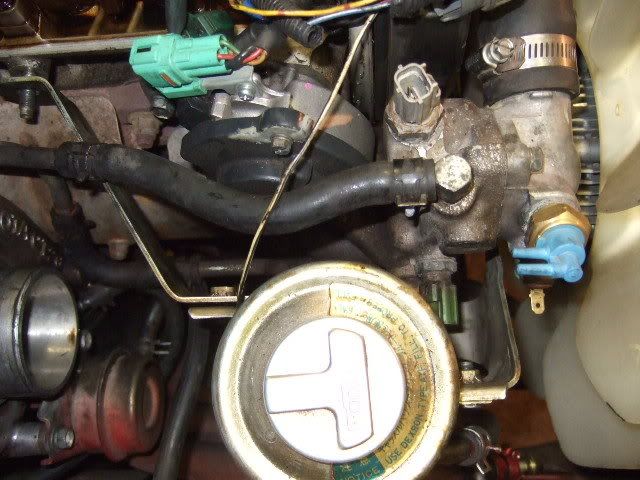

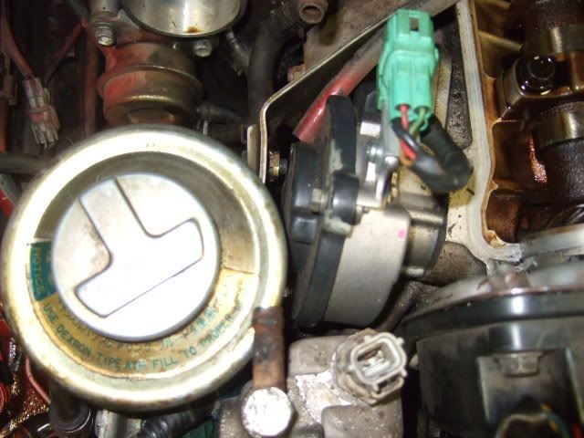

I also did some modification to my Power steering Resivor bracket, It now sits about 2-2.5 inches closer to the block. This will give me more room to rout my intake.
BEFORE
AFTER
Mr.PFloyd
I am the Super Devil
Authorized Seller
Contributor
Joined
Jun 22, 2005
Messages
3,964
Location
Mississauga, Ontario
Re: So it beggins......Delilahs build
what happens when your cps is out of whack? ;)
What most people do is use the NA one, check them out!

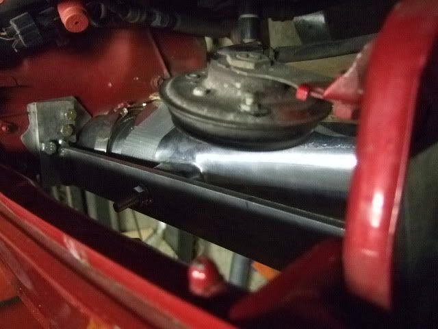

So I finished the top mount this after noon, check it out

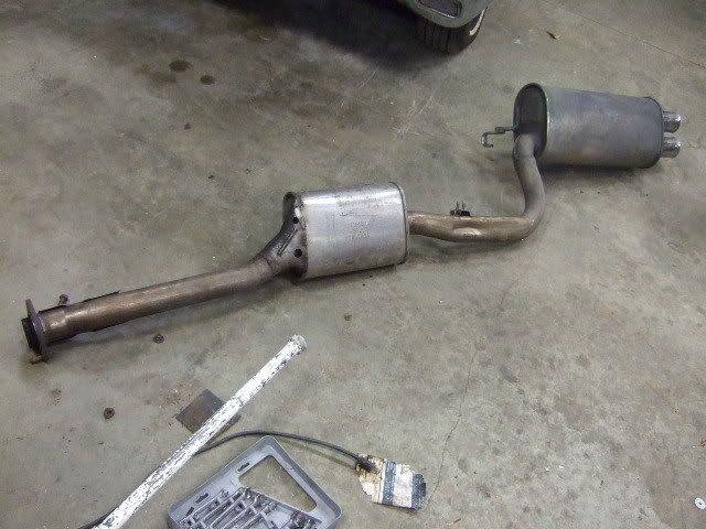

I also pulled my exhaust all the way off. Looks brand new, not a spot of rust on it. I dont even want to know what the prev owner dropped on a new oem exhaust.

The PS bracket doesnt touch it so it wont interfere with setting my timing. As for having a cps go out I have 3 working spairs so Im not too worried, and why would people want to go back to a distributor???

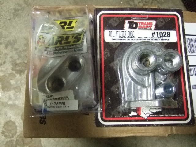

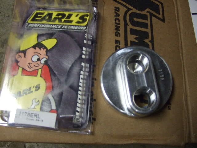

I also figured out how Im going to mount my oil filter and got the mount partially built. As well as started polishing my Power Steering Reservoir. Ill post pics tomorow

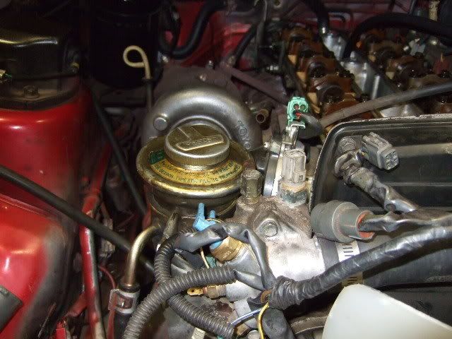

I decided to move my power steering Reservor to clean up the engine bay a bit and make my intake a little easier to build. The brackets need cleaned up a bit but I think the new location looks much better than stock.
Heres what my turbo intake looks like, I just have to weld in the ports for my pcv, and BOVs

I found something strange when I pulled the turbo off. The inside of my turbo and manifold were white? At first glance I though Sh#T this thing was running lean but quickly drew the conclusion it must have been from burning coolant.
After taking the manifold off I was even more confused. The exhaust ports on both the head and the manifold were black and sooty just as I would expect, and the head gasket was only slightly blown on 3 cylinders? So on top of it looking normal on the engine side of the manifold I highly doubt it was burning enough coolant to cause this much deposit. The white look similar to calcium deposits and is hard and pretty rough and textured unlike regular exhaust carbon build up. In the manifold it starts black and transitions to white 1-2 inches down the runners.
I cant really think of any clear cause. I started thinking mabye my turbos exhaust housing is cracked and coolant was leaking into the turbine housing and getting vaporized. Nothing exactly fitss in my mind as I dont know why the deposits would start in the manifold if it were a crack in the turbo and I dont know why they wouldnt start back in the head if it was burning that much coolant??? Any ideas or experiences are greatly appreciated, Im pretty stumped

Seen the white inside the housings a few times and it's usually something in the fuel.
The white on the outside looks like fluid leaks.
Yes the crank bolt is normal righthand thread but it's 195 ft/lbs.

ya I got the gasket set looks good, thanks. So the white isnt anything to worry about then? I just hadnt seen it on any of the other supras Iv worked on. As for the crank bolt I was sure it was righhand, at least I though it was thinking of the last two I did, but after it snapped my 1/2 drive breaker bar I started second guessing. Sure supprised the hell outa me when it happened:biglaugh:
