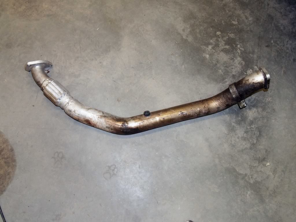

Currently the turbo is off and the down-pipe got picked up today to go to the shop for some Bung Welding. Wideband here I come...! :)

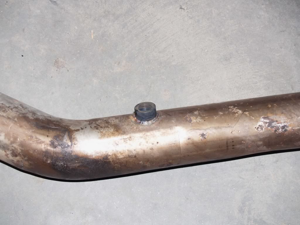

Got my downpipe back yesterday and the bung-holio looks good!!! :biglaugh:
Note where my EGT is plumbed...

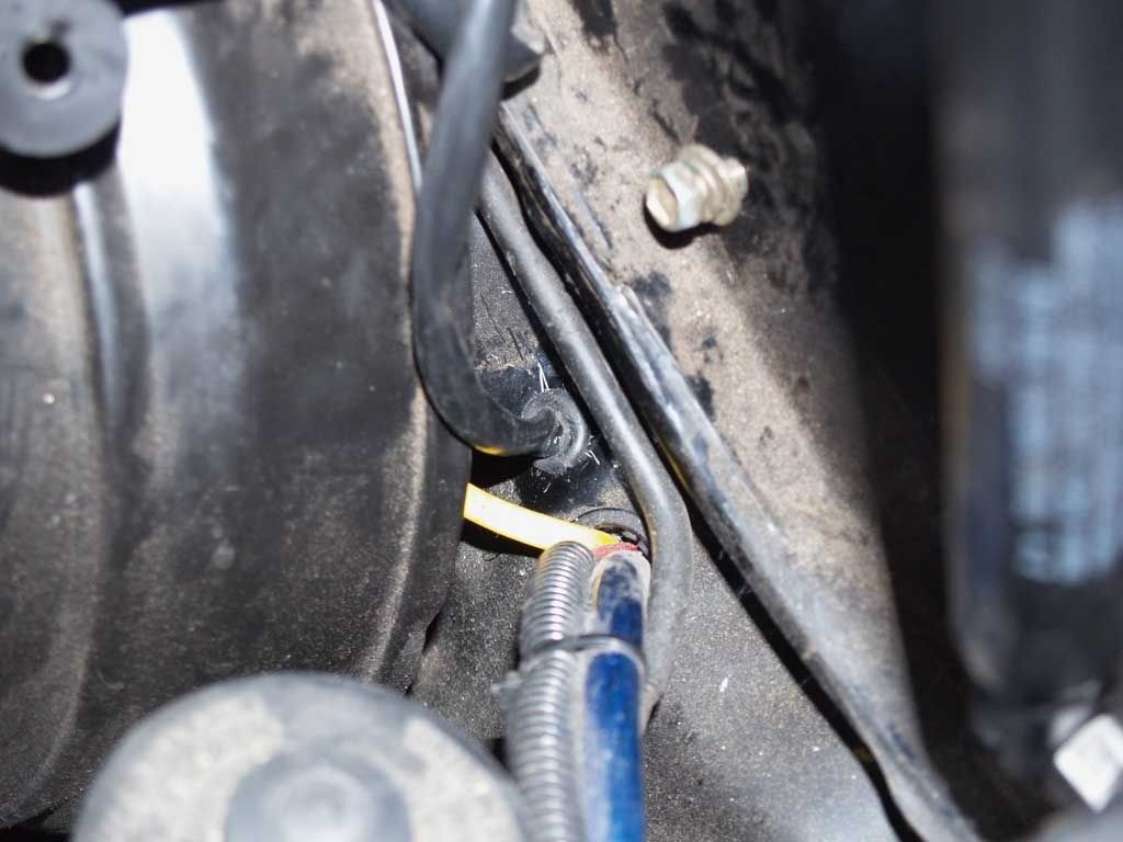

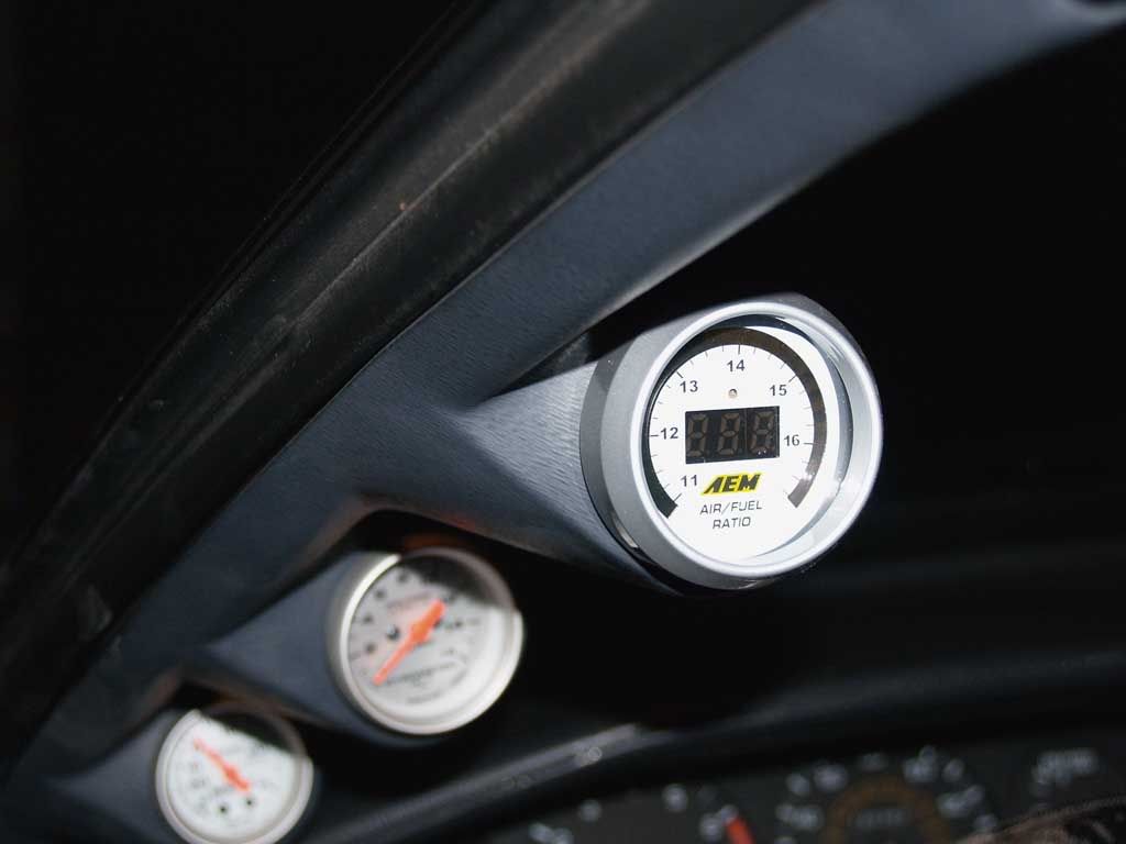

Ok. I got the WB sensor mounted and the DP back in. I ran the WB wires up behind the brake lines and followed the main harness to the passenger side.
There I had to drill a hole and install a grommet. After that, I removed the old Narrow Band AFR Poop-of-A-Gauge and mounted the new one.
Here are the pics.

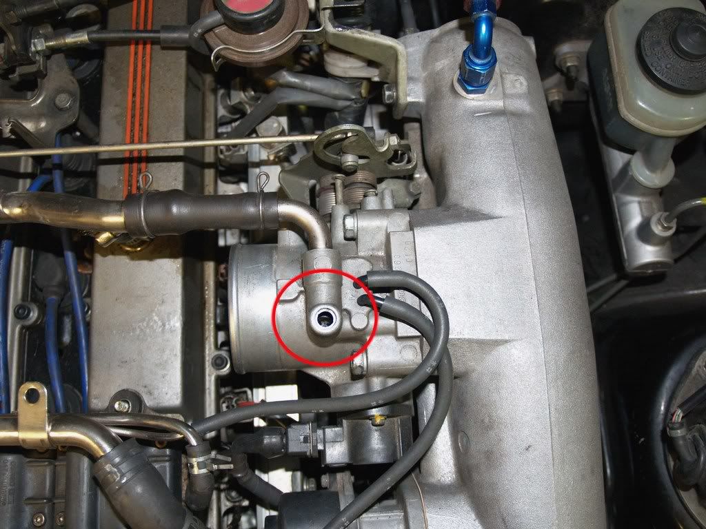

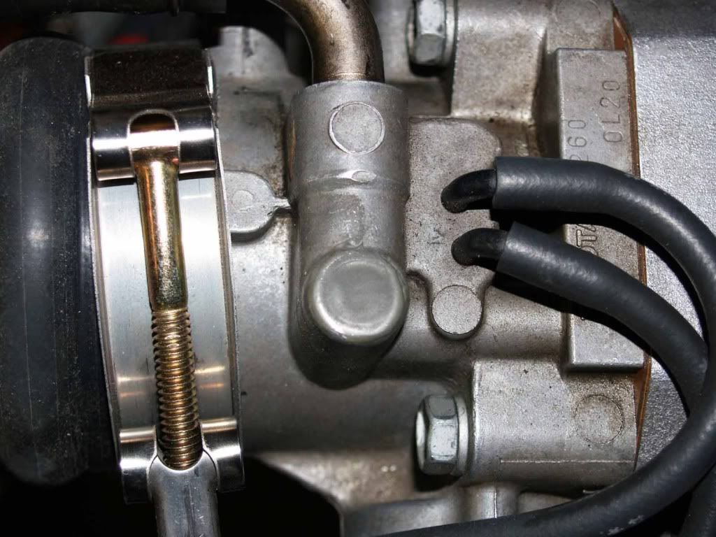

I fixed the hole in the TB with a cut screw and some JB Weld. We'll see if it'll hold.
I know what you're thinking...and no, it doesn't look bad. ;)
Here's a pic of it.

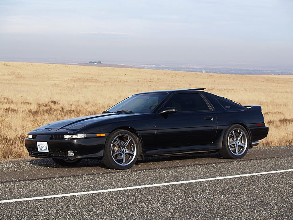

Hey Kenny, your car looks great. Nice work! You might want to check out the clear bubble front marker light lenses that Wolfie makes, they look really good with the clear front corners.
suprakid24
Turbo'd
Authorized Seller
Joined
Jan 6, 2007
Messages
521
Location
Texas
Car looks good! I like this pic the most.

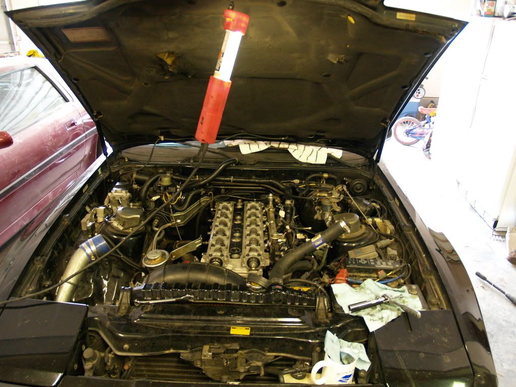

Ok. My latest "Supra" event was that my timing belt decided to jump some teeth. It jumped one tooth on the exhaust side and four teeth on the intake side. :aigo:
I got it all re-aligned then noticed a small tear in the center of my timing belt. I'll be replacing that soon!
Anyway here's a pic of my tooth jumping event.
