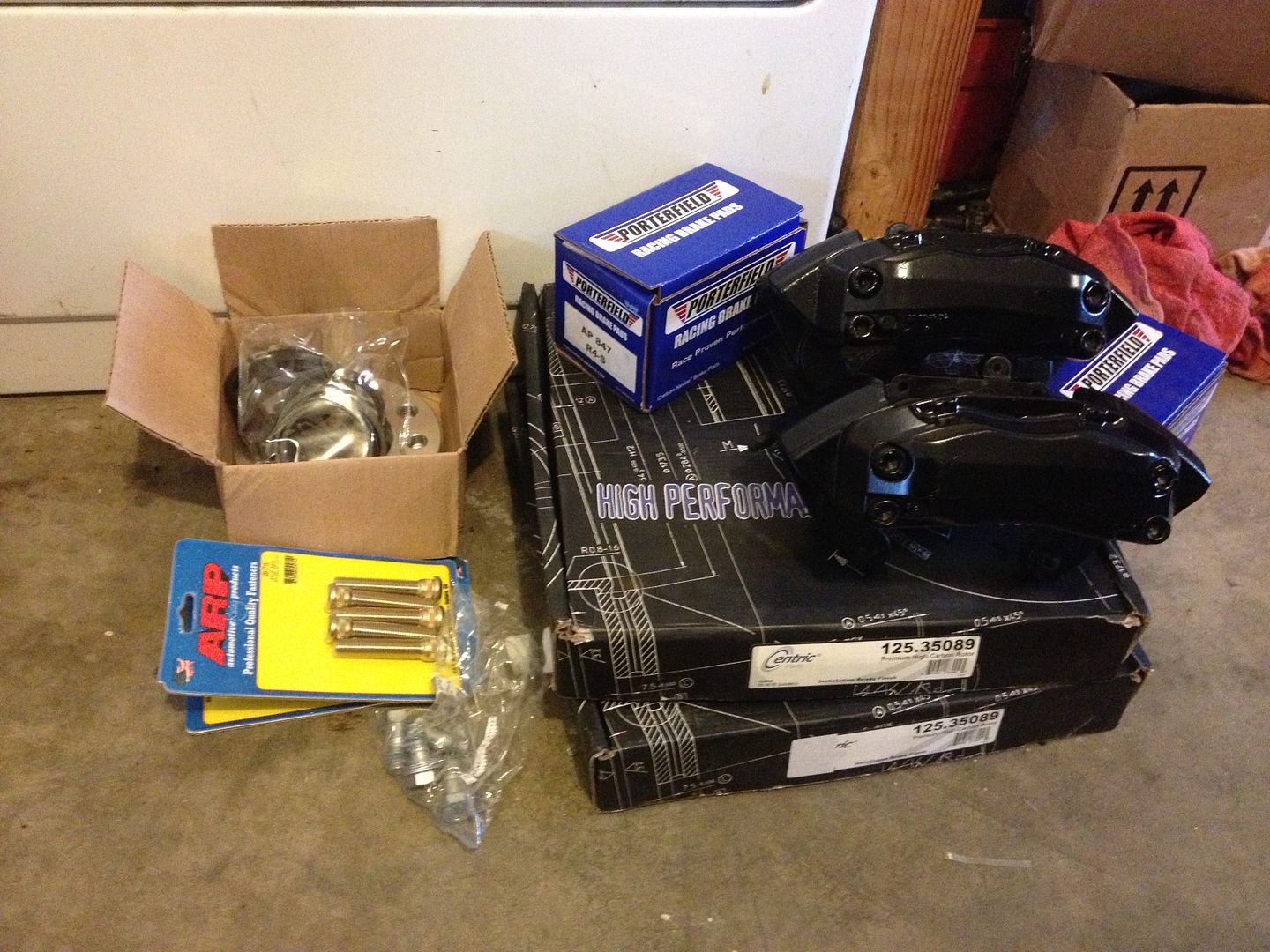

figure I'll share mine. got the calipers for about 70 shipped. rotors were about 130. new seals and boots were 25. new braided lines were 54. new washers were 17 for qty10. powder coat was about 100. silver matalic with clear. and just threw on 8 dollar brembo decals. hub centrics were 12. see pics.
I'm probably going to tackle this after I'm done with my 1uzfe swap this summer.
