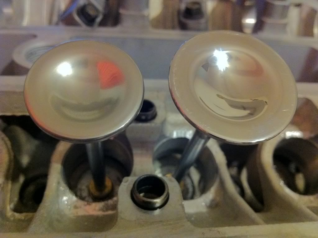

Started a year ago, I think the progress is very decent. First wanted around 700hp, then it all changed. :naughty:
Plans:
1200rwhp through a Powerglide
Mid/high 8 second passes
Awesome drag car/ along with weekend cruiser
Current Items (Sure I'm missing some)

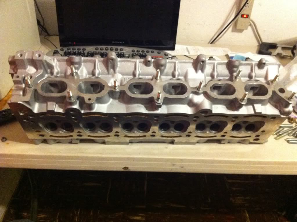

Head:
Race port & polish head
Ferrea Competition Plus SS Valves +1mm
Supertech Dual springs
SIP Racing 290 cams
SIP Shimless Buckets
Mirror Resurface
New/custom machines valve stem seals
New valve seats
5 angle valve job
Viton seals
Cometic MLS Exhaust Gasket

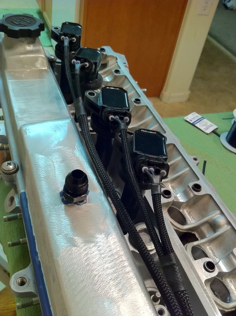

Custom Valve covers, powder coated, -8 PCV, -12 Oil Drain Hose
Custom FFIM, polished

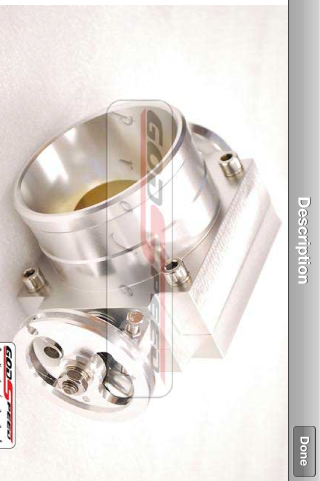

Custom 90mm TB (grooved o-ring with 3.5" V-Band)
Thermal Intake Gasket
TMS Cam Gears
Gates Blue Racing Belt
SIP 1.3mm MLS HG

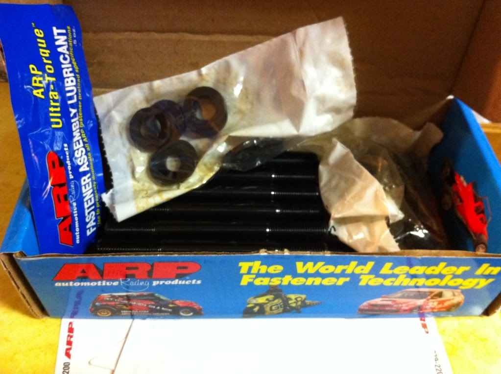

ARP Head Studs

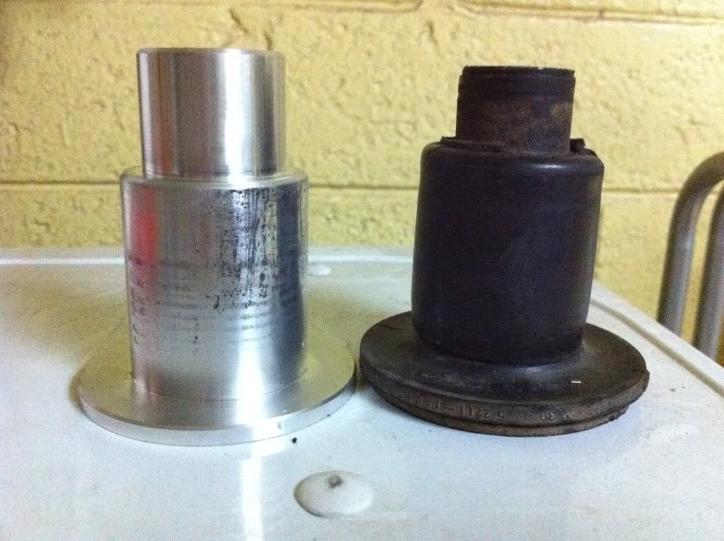

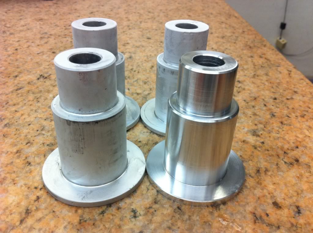

Custom solid aluminum front/rear subframe bushings

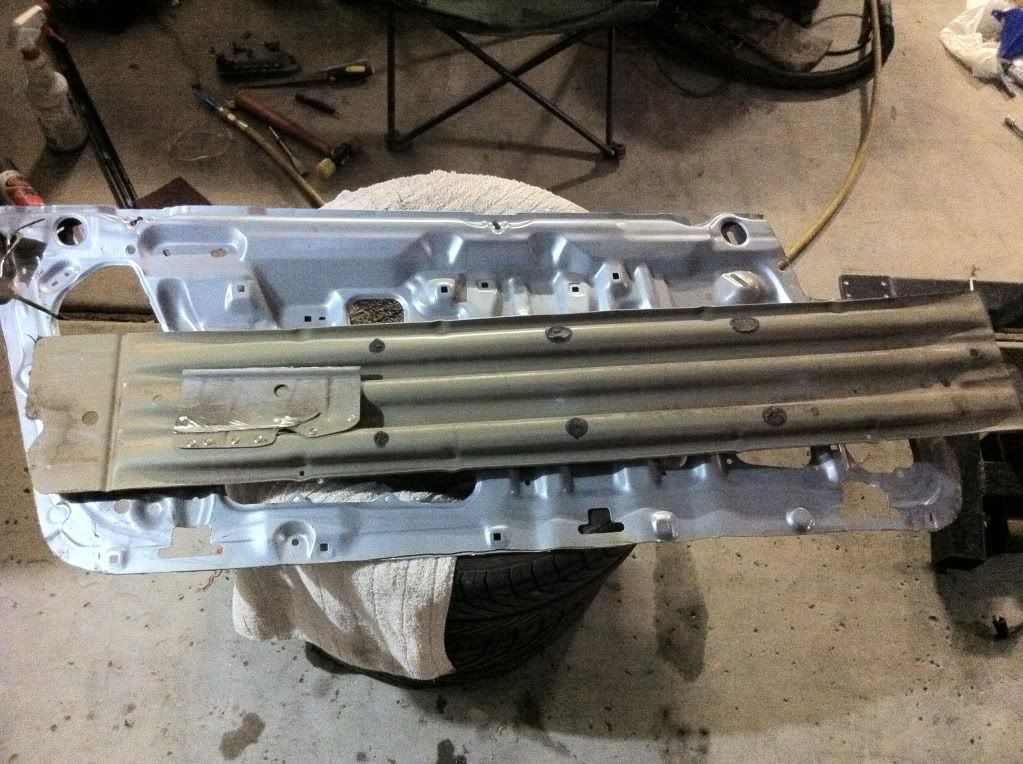

First Tear Down

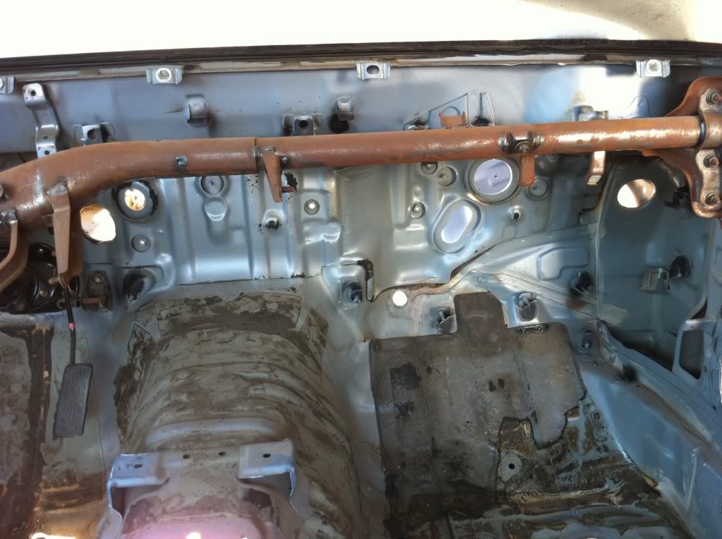

Firewall before
Firewall after

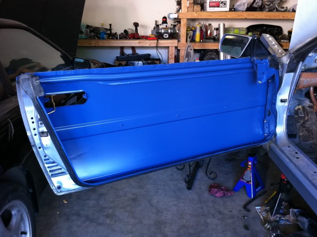

Gutted Door
Prepping for stitch welding

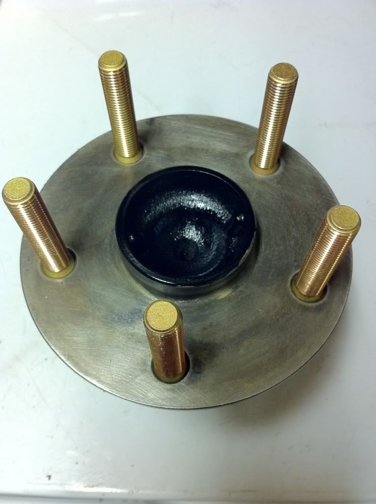

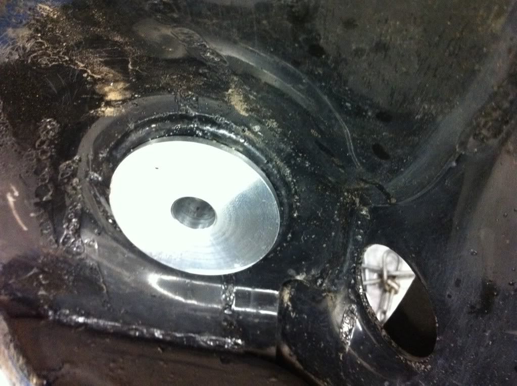

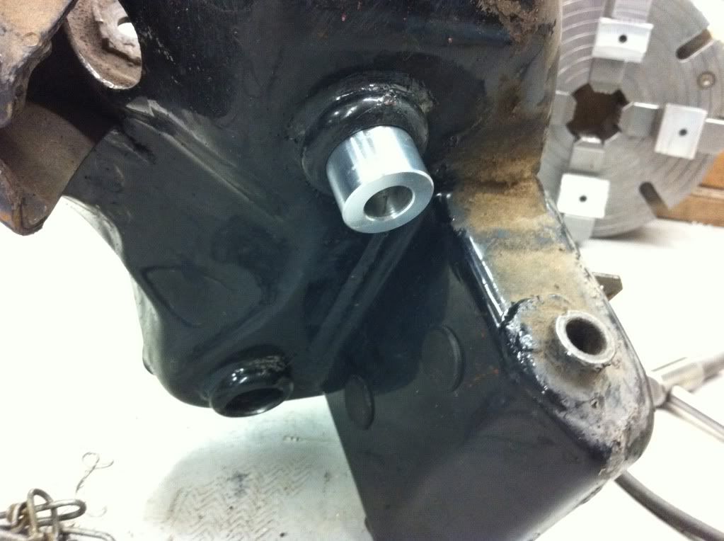

Solid front bushings

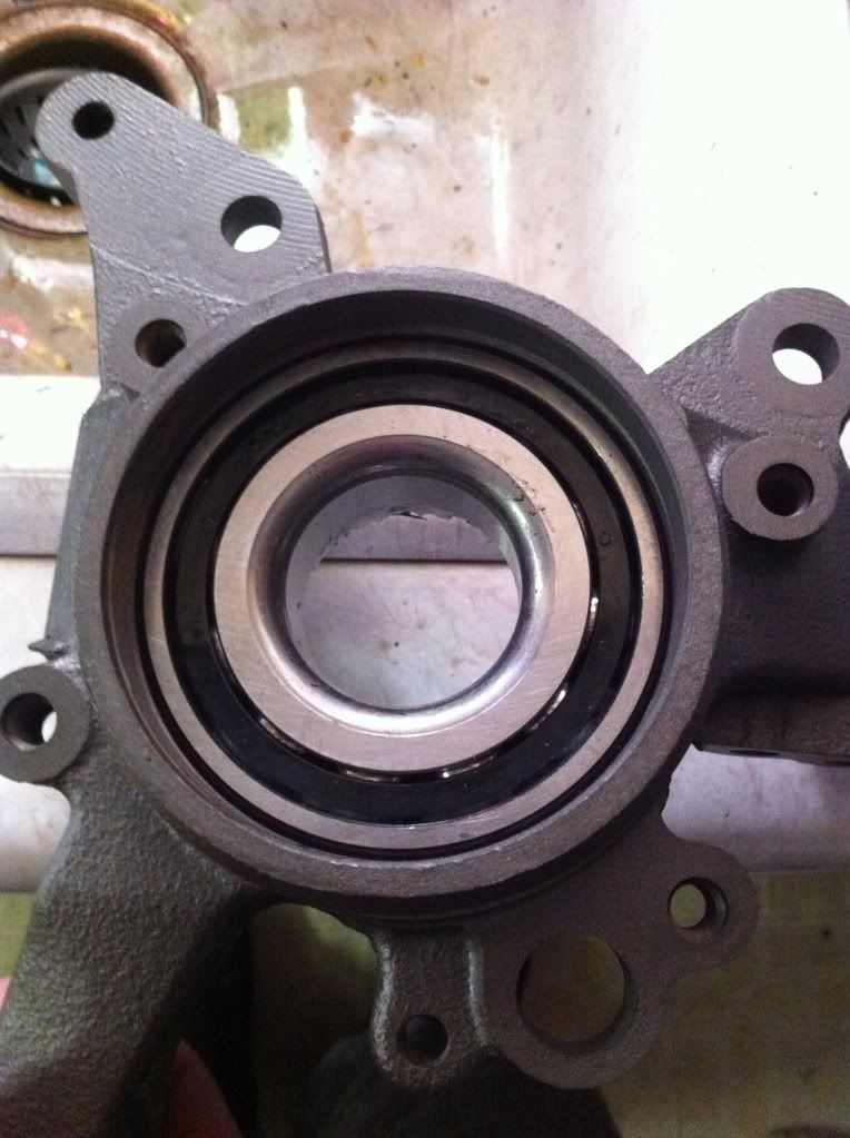

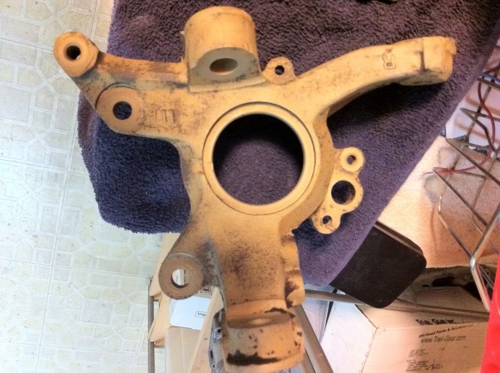

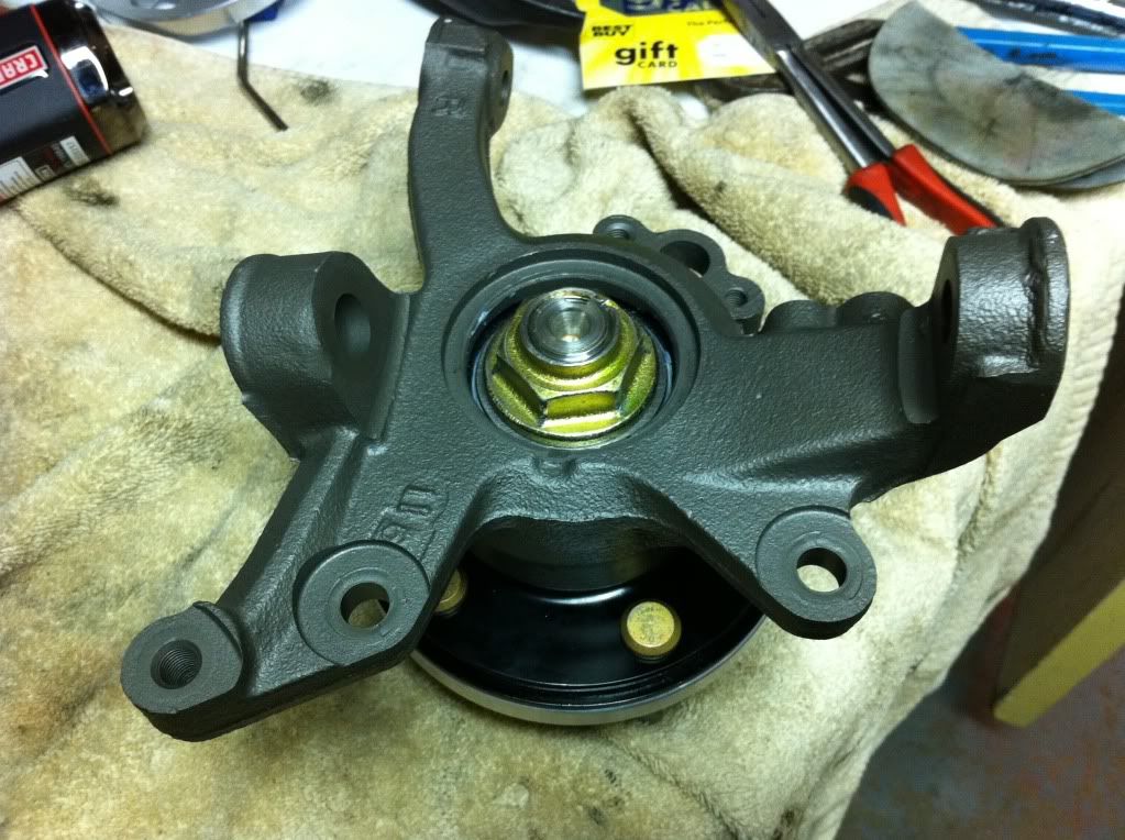

Sand Blasted front hub
Extendedness
Painted hub/new bearings

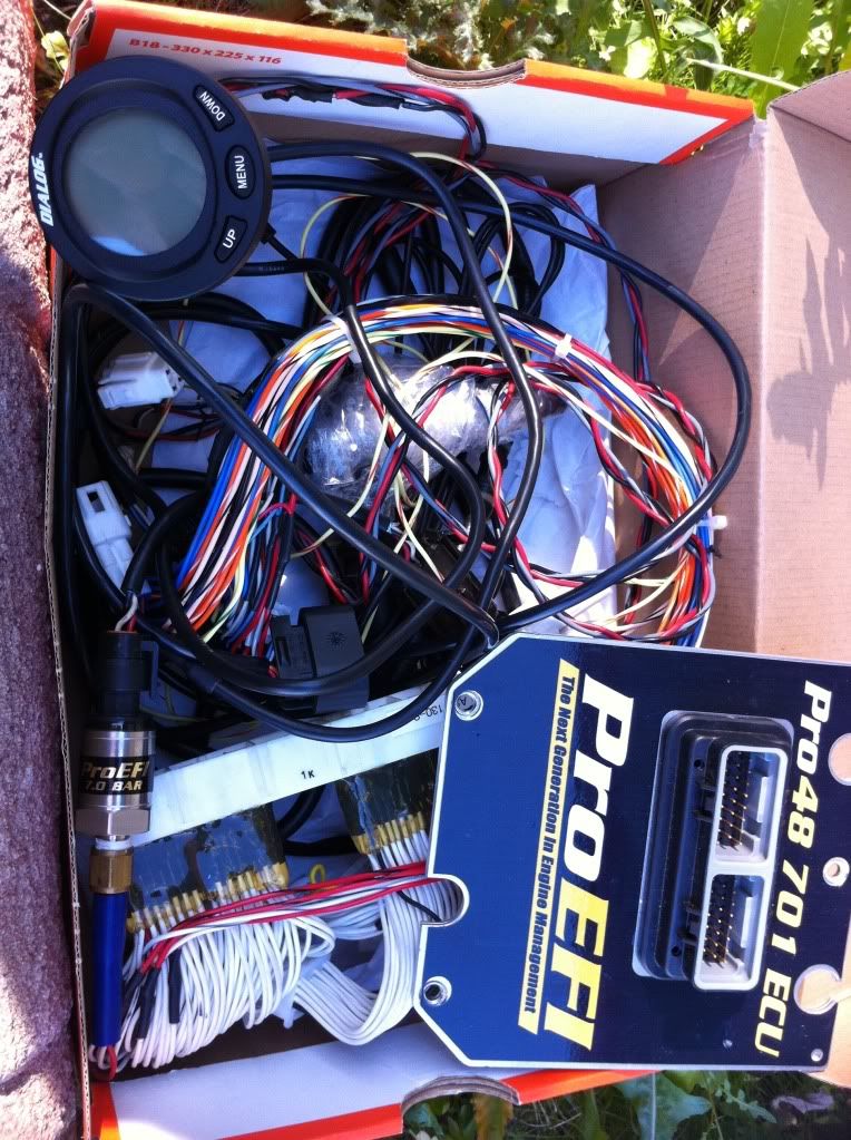

ProEFI

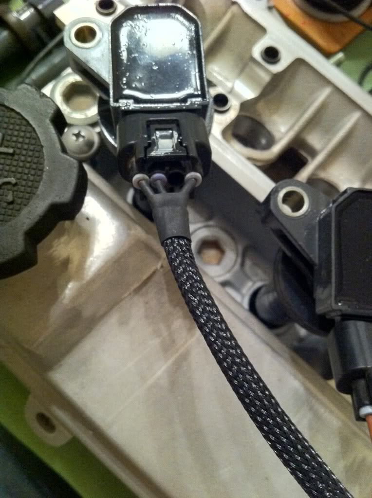

Wiring harness/1ZZ

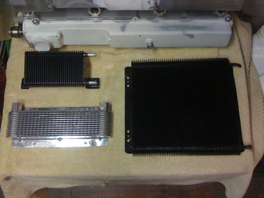

Coolers

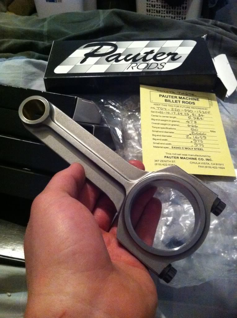

Pauter Rods

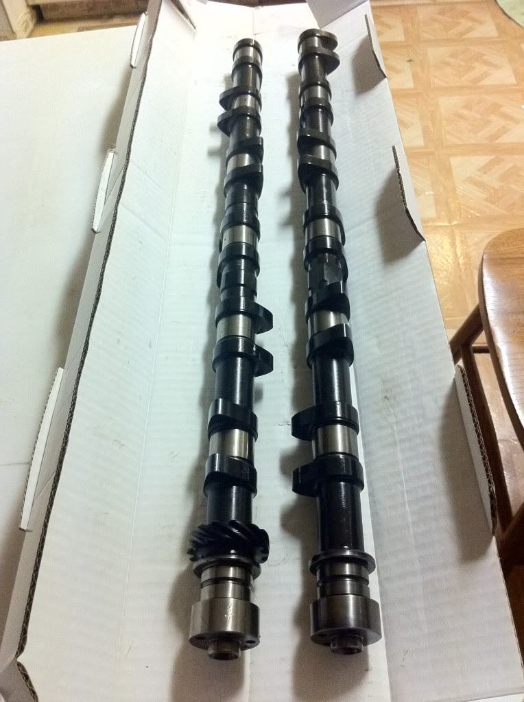

SIP 290 Cams

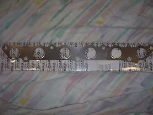

Cometic MLS Exhaust

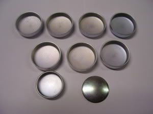

Freeze Plugs

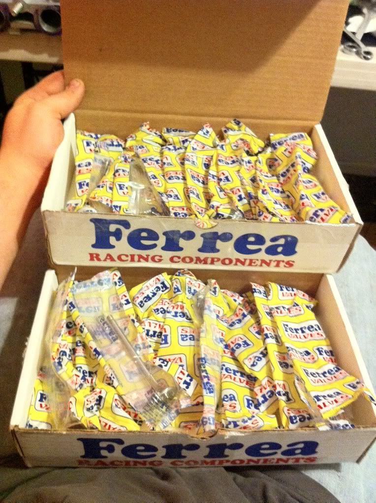

Ferrea Valves

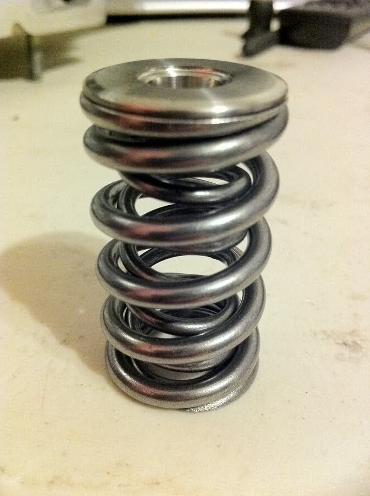

Supertech dual springs

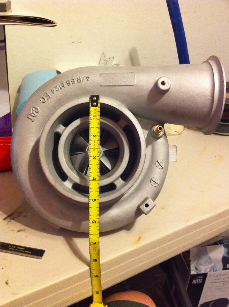

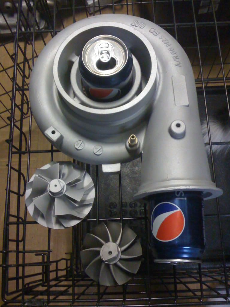

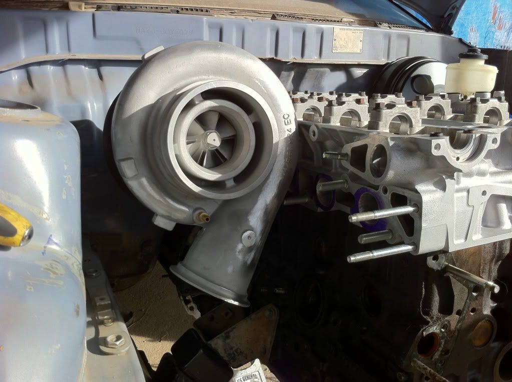

GT42
Ceramic

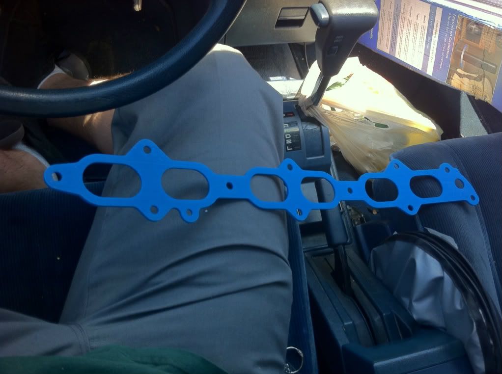

Thermal Gasket

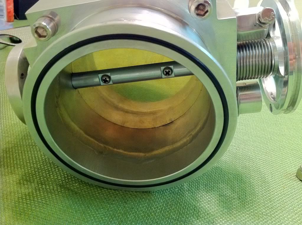

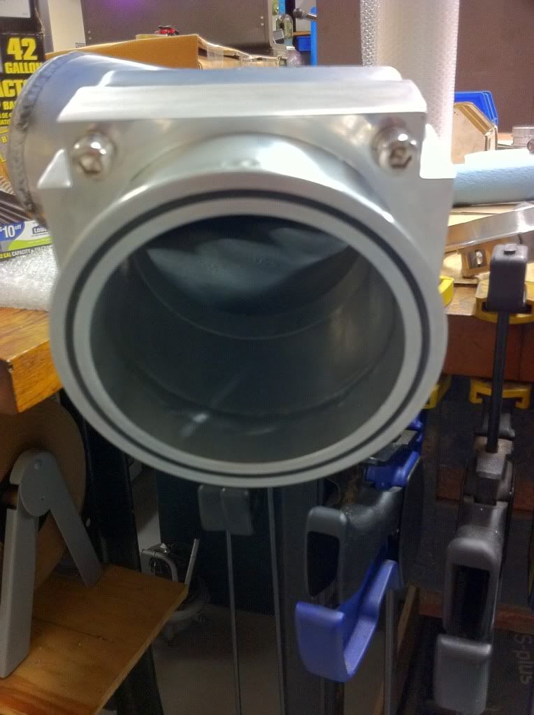

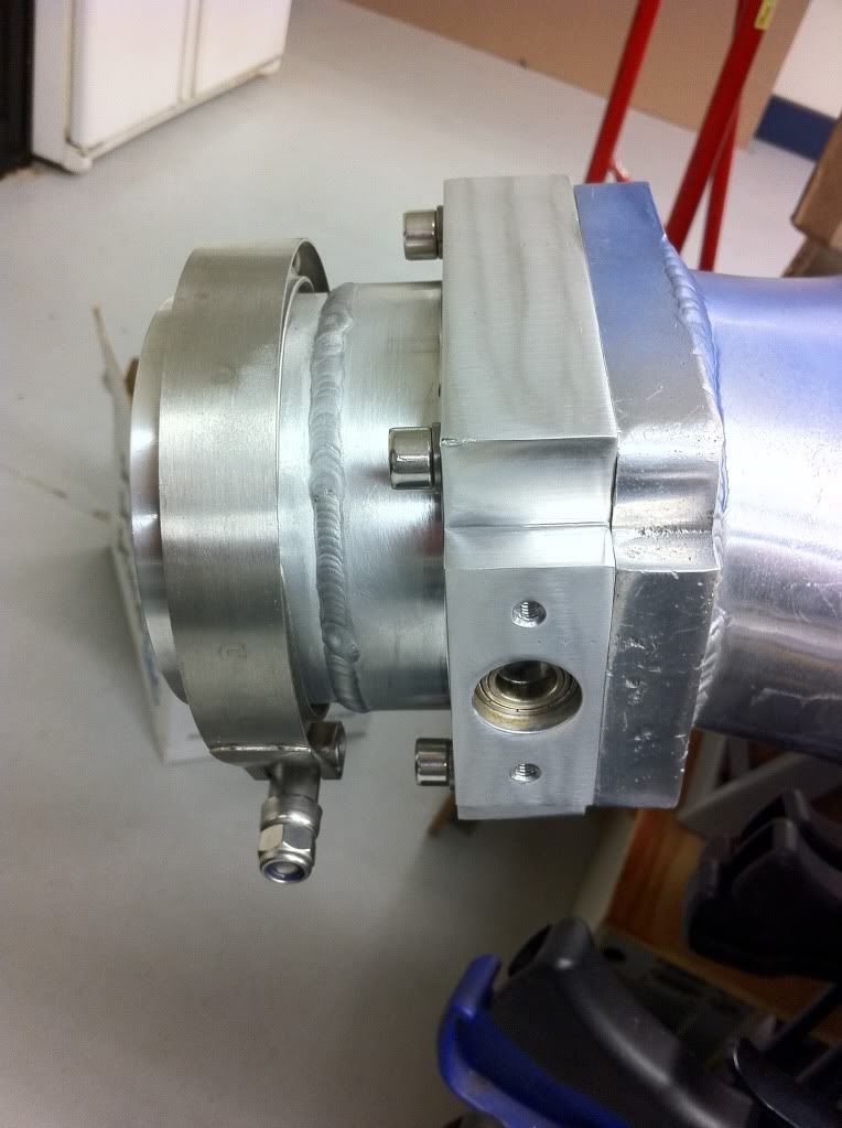

90mm TB
O-ring groved
3.5" V-Band

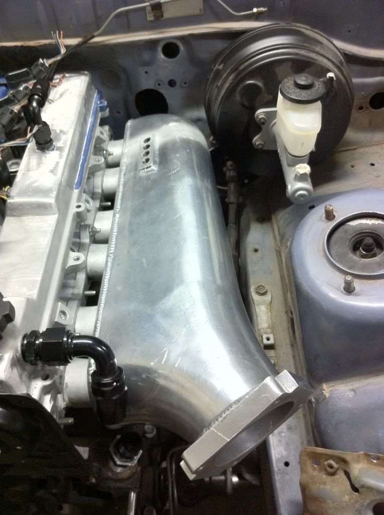

mock up

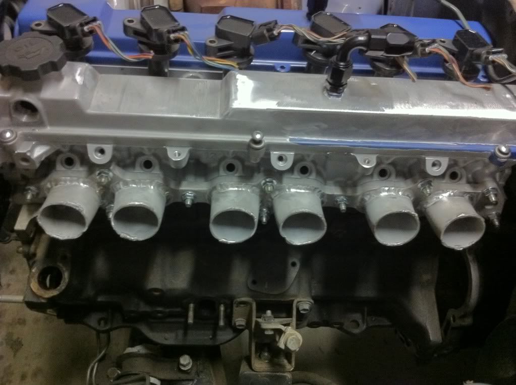

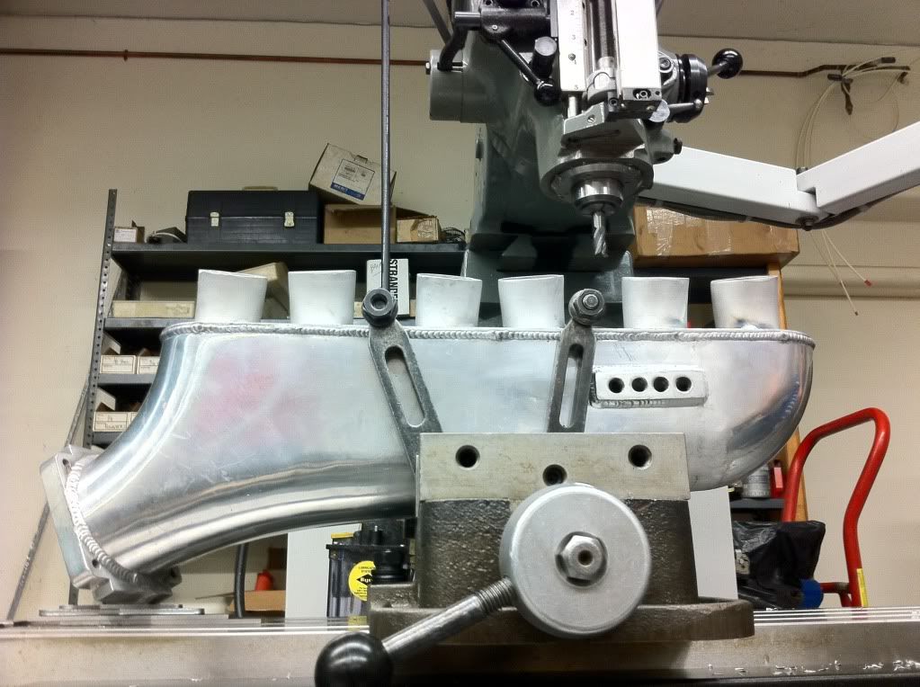

1jz FFIM modded to fit 7M

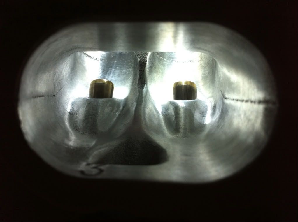

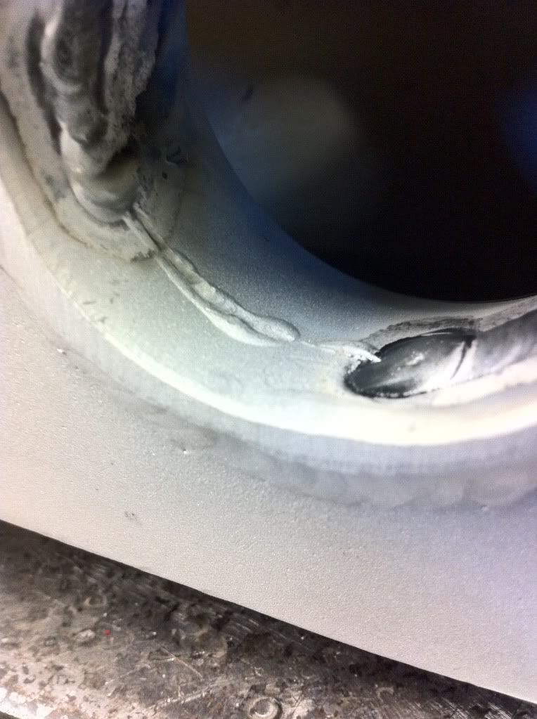

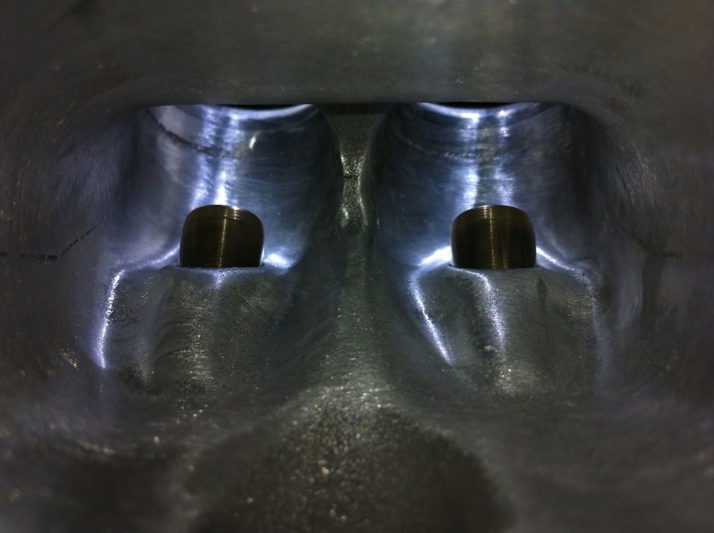

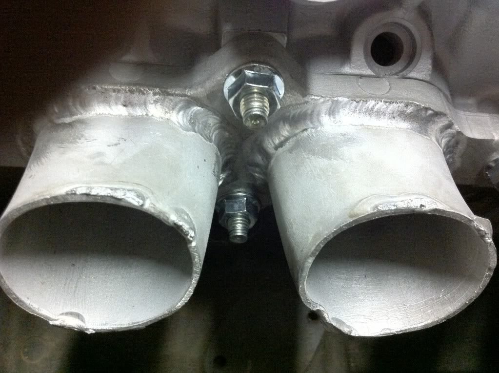

Fixing weld blow though

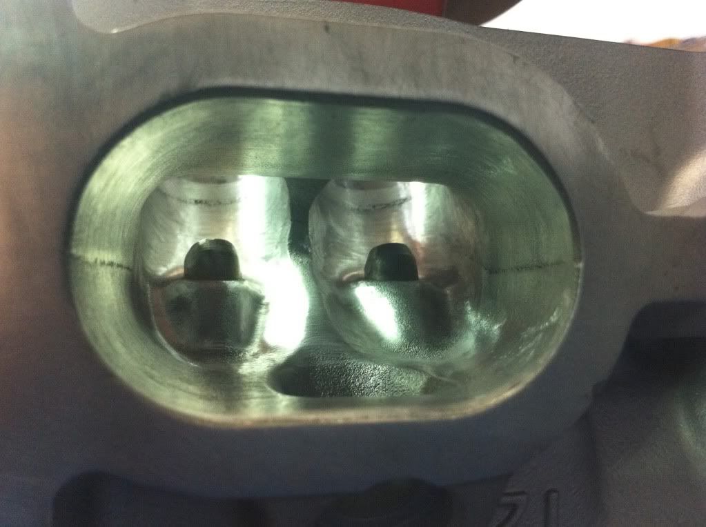

Getting ready to blend

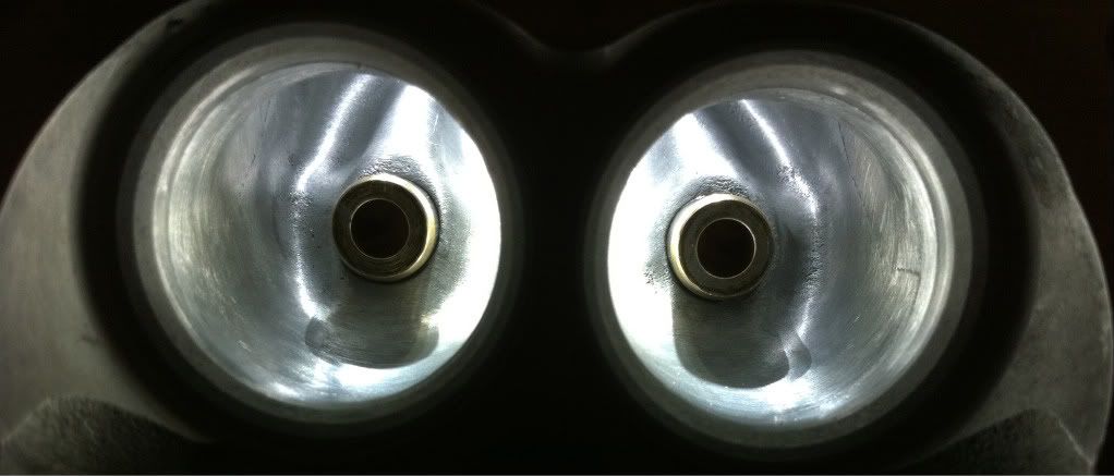

Runners modded and now fly cutting
Runners welded

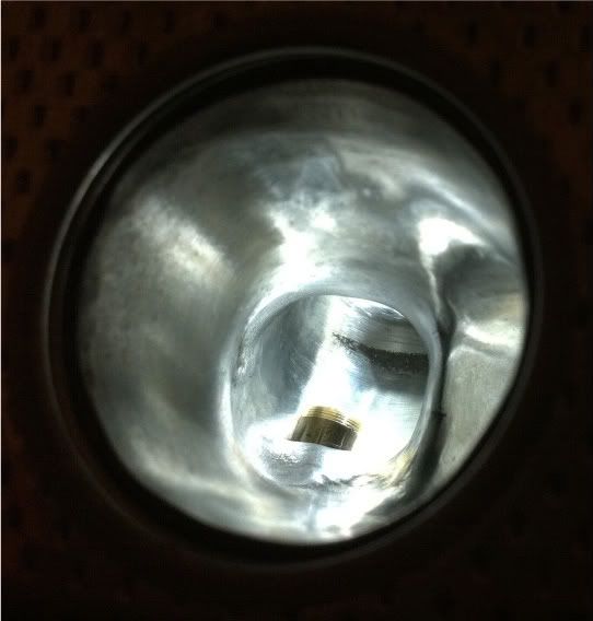

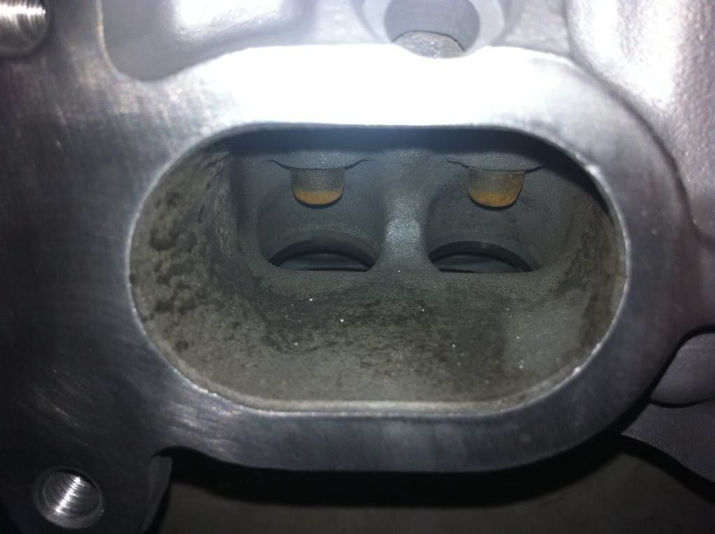

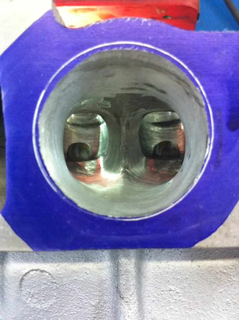

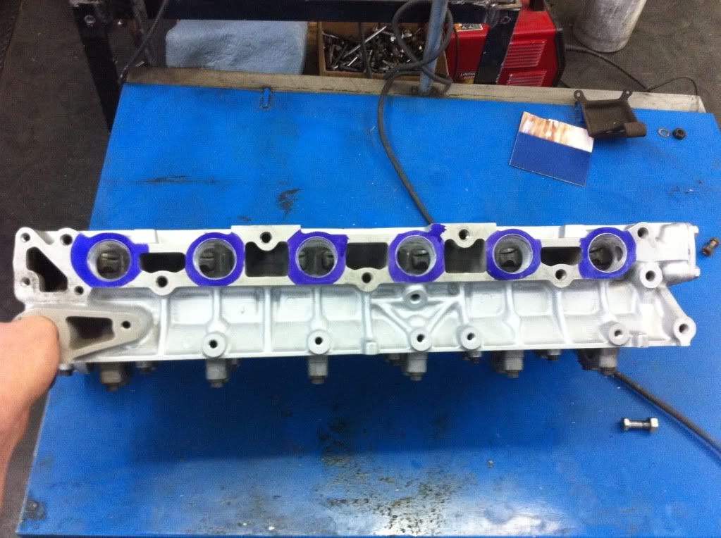

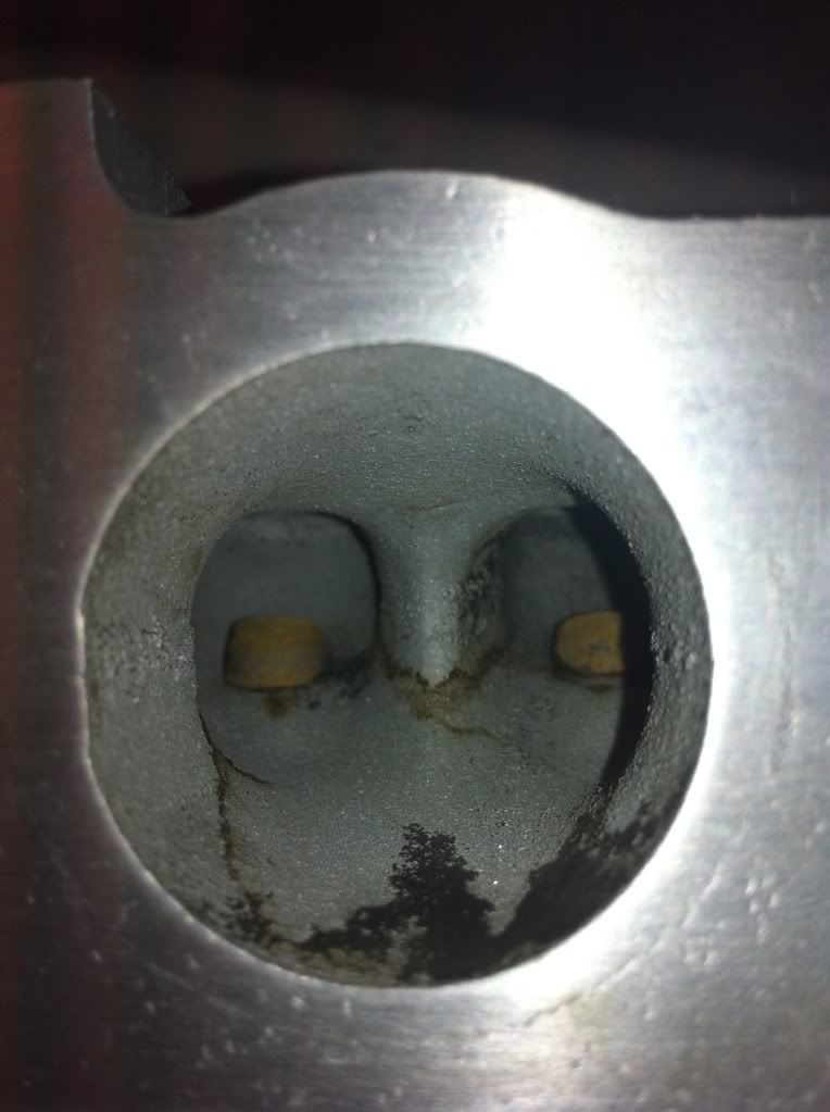

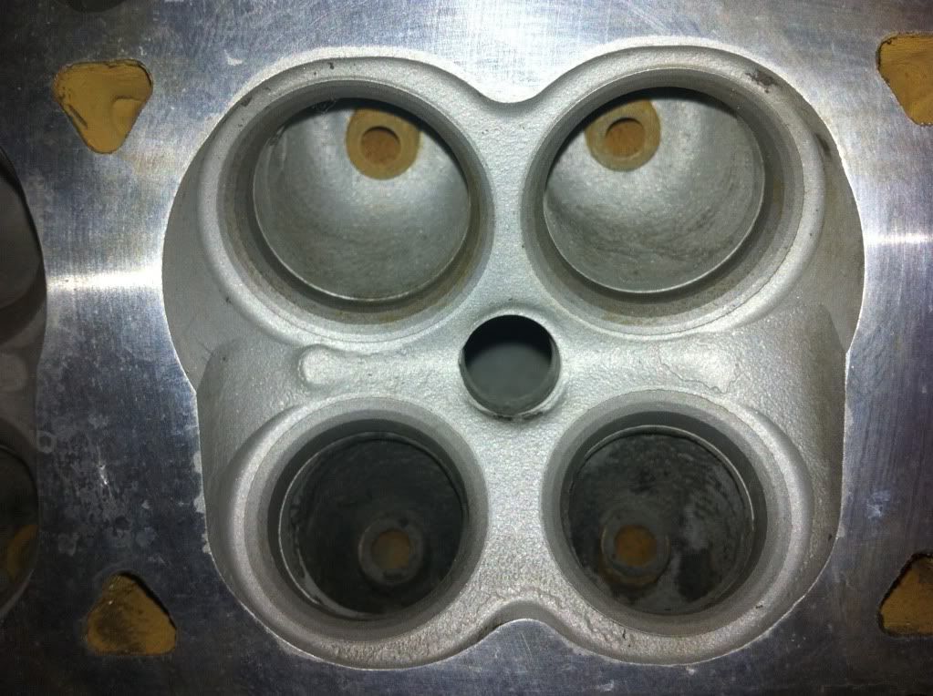

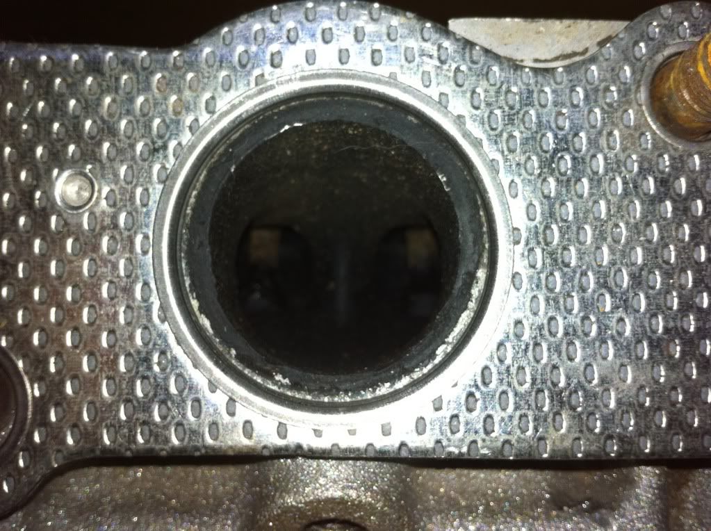

Port before
After

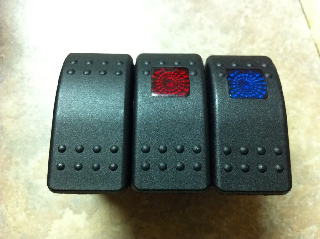

Switches to start wiring

Getting my head back from the machine shop next week along with my valve covers from the powder coat. I have to order the shimless buckets to size once its back and should be able to start on a stock block for my bday cant wait!
Also should give a shout to Rich @ SIP Racing for alot of info and parts

Multiple people here in AZ the build cars for Full Race and AFI use aluminum exhaust. Either it be a 900hp honda or XXXX supra
I haven't bought any stuff for the downpipe yet so I still have time to change alittle. I just have a vband and that's it.

What are your plans for coolant and oil systems?
New oil pump, shimmed, filter relocation to the front, using a 2qt filter, then to a micron filter, and oil cooler
Coolant nothing special, I have a koyo radiator, fal fans, would like to find an electric pump that would eliminate a belt just needing an alternator belt.

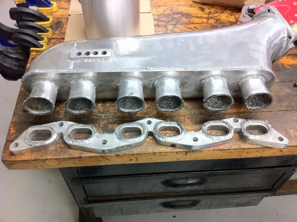

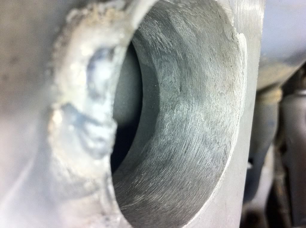

Lots of time, welding and blending put into these. All screw holes filled, blended flush, 3000 pipe mounting welded up, tapped for AN fittings
Straigh from powder
Before
