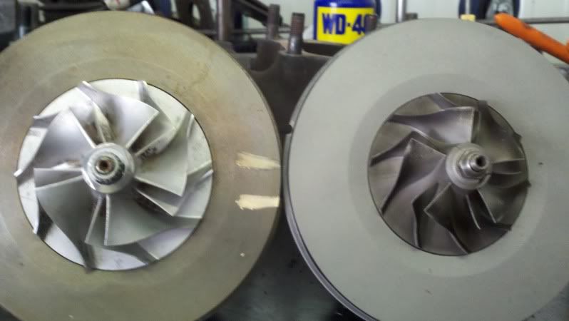

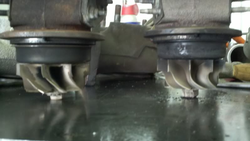

Comp wheels. Group A on left.

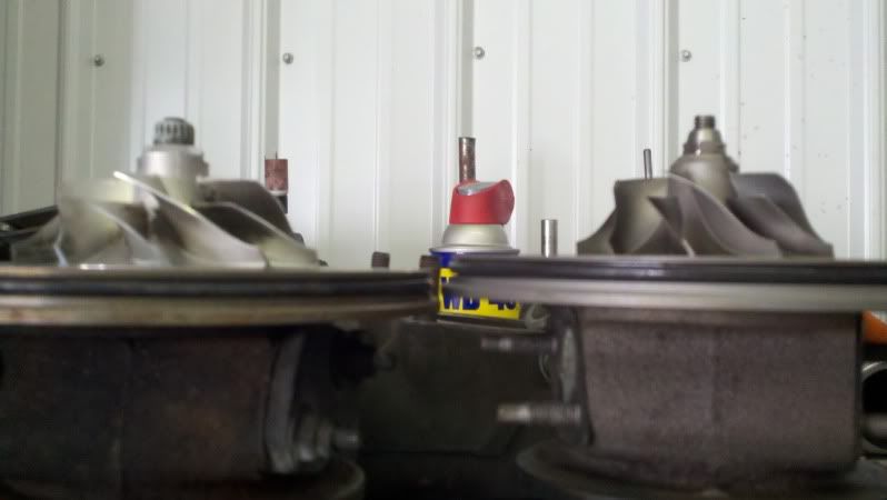

Comp wheel height. Group A on left.

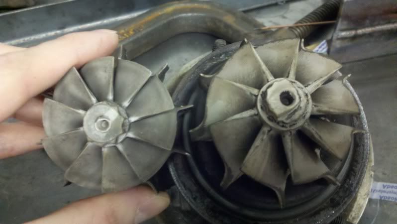

Turbine wheels. Group A on right.
Turbine wheel height. Group A on left.

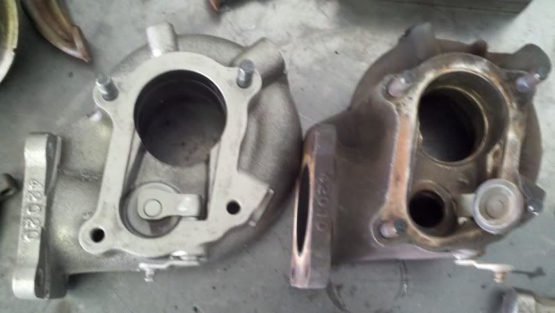

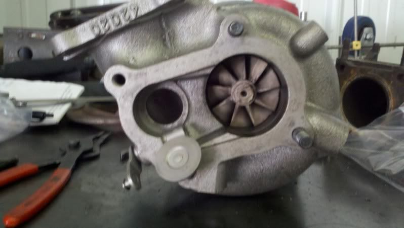

Turbine housings. Group A on left. Notice the size difference.

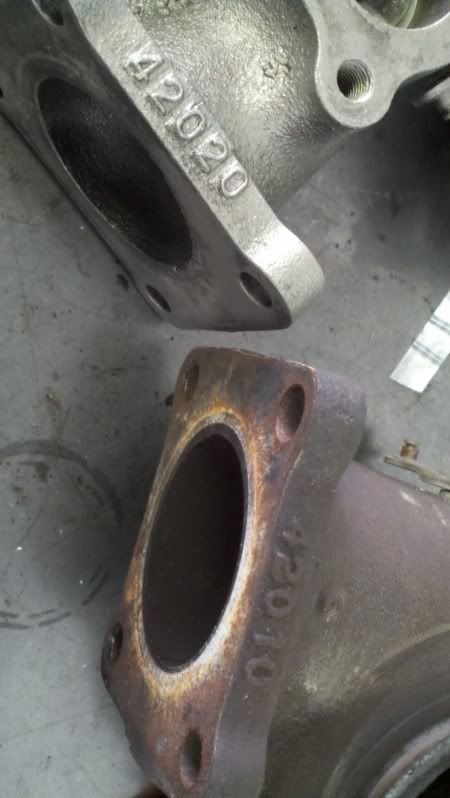

Turbine housings. Group A on left. Notice the part number difference.

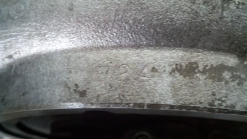

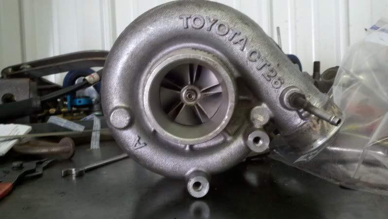

Compressor housing of the Group A. Serial number possibly?

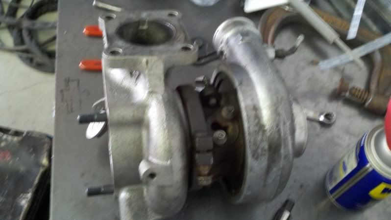

Group A from front:
Group A from side:
Group A from rear:

Firstly, thanks for uploading pics of this.
However I am rather curious in the difference between the Group A CT26 and Turbo A CT26, that is if they are not the same ?
I own a Turbo A and by the looks of it, the turbo's are exactly the same, except the exhaust housing is rusty on mine, and have the same part number 42020. The only difference I recognise is that yours is missing the stamped "E" on the intake side.
Is there anyone out there that can confirm differences between Group A and Turbo A ?
