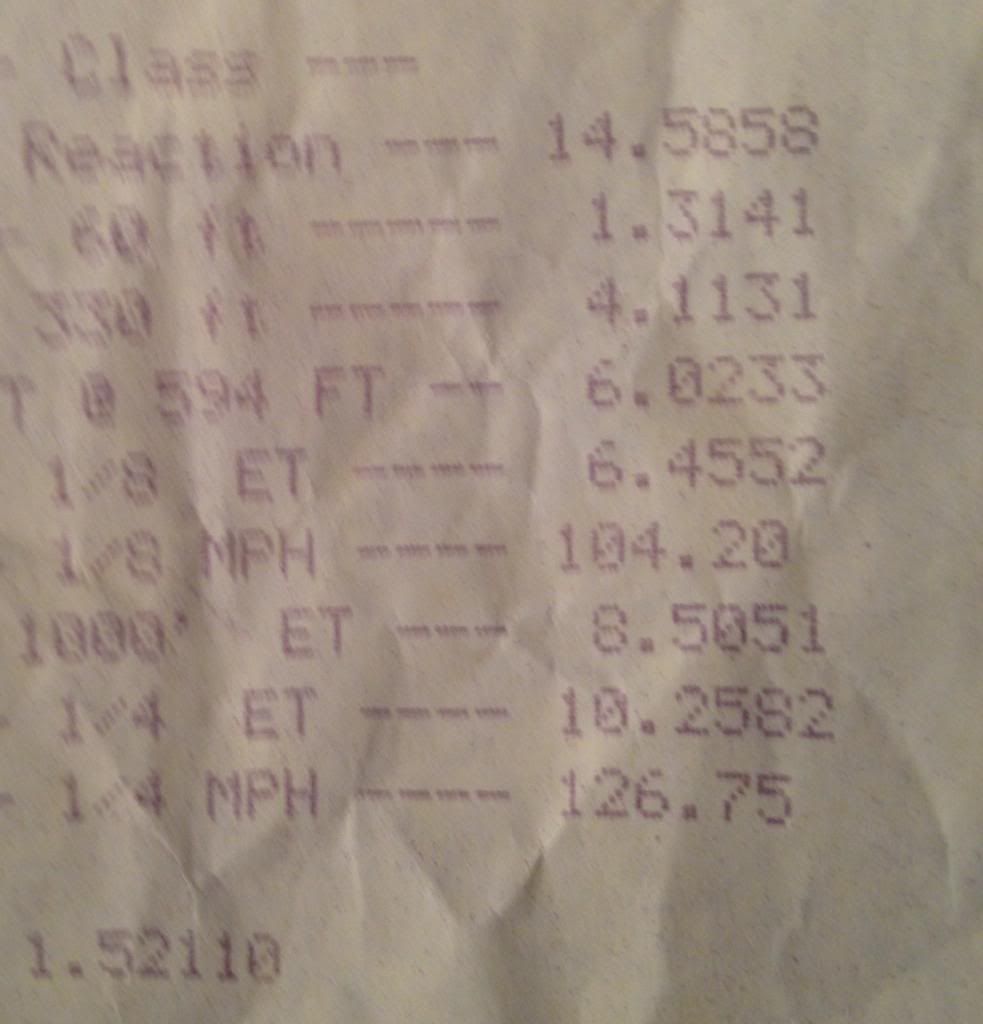

Had a good first outing, and a great first run in, but broke the diff second pass. We got some great feedback from the car, and once we get the diff fixed should be able to muster up a high 9 second pass. Onto the vids!

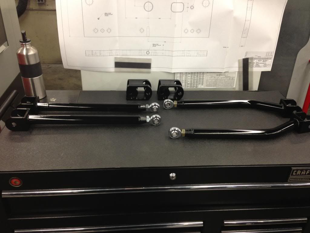

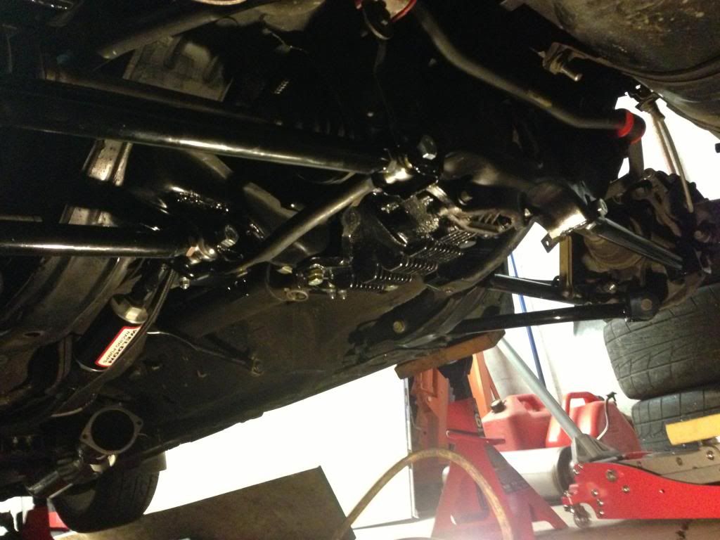

All the link bars have been remade with heim joint ends in 1 1/4" chromoly, as well, the rear track bar is now more of a J shape to clear the 275"s. I also made a strut spacer that brings my silk road coil overs inboard about 1.5" to clear the 275's as well. So I guess the short answer is no, its not a completely stock IRS setup.

Its hard to see in this picture, but if you look closely you can see all the link bars

The heim joints I used are 5/8's heims with 5/8's through holes. I had to drill out the hole where one of the link bars meets the hub assembly (it has a tapered ball joint style fastener on it). If your careful you can drill it out and use an 8.8 grade bolt in there instead of the tapered shank. When I made the other 2 ends that attach to the hub assembly I made the plates with the same diameter metric bolt that they use from factory.
Then on the sub frame side, I ended up grinding off all the elongated holes and welding in plates with 5/8" drilled holes to lock the heim joint in a static location. From there you can adjust each bar to get your alignment exactly what you want it to be.
Here is 2 of the 3 link bars. The one thing I plan to modify on the straight bar, is to add another adjustment point where the bar meets the u shaped mount. It made it tough to align when I brought it to the shop to do the alignment, having it solid mounted at that end. If you look close, you can also see the mounts to bring the shocks inboard as well.
