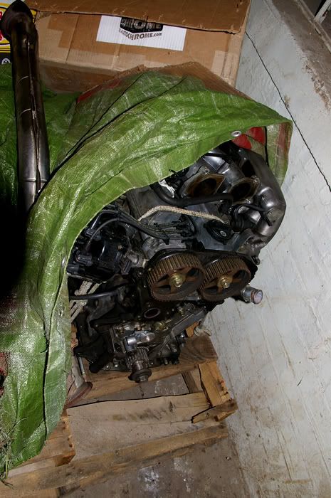

Now as far as the 2jz is concerned, here's the story so far:
I picked this ^ motor up from a local Mkiv guy who swapped a gte in his n/a for the low sum of $500.00. Internally, there isn't a score on either the cams, caps, rod, or main bearings. The thing looks brand new inside...
After preliminary disassembly, everything was placed in sealed plastic, with accompanying nuts/bolts/etc...To keep from losing anything.

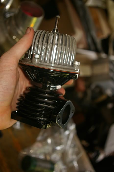

100 = Genuine HKS 38mm Wastegate (After Powdercoating...)

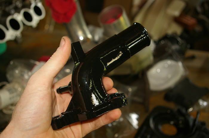

Small update: Powdercoated the waterneck, then realized that the grit in the sandblaster was a bit too coarse, so powdercoating is going to be on hold for a little bit until I can remedy that...;-)

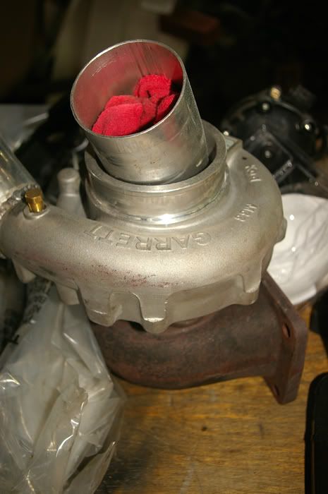

that pipe in the turbo is how the guy I got it from had it installed previously...and yes, it's being cut out, and I'm contemplating powdercoating the front housing black, but I'm still up in the air about that one.
MK3Brent
Very expensive....
Authorized Seller
Contributor
Joined
Aug 1, 2005
Messages
2,888
Location
Greensboro NC
You can leave that pipe.
It's probably welded to the anti-surge shroud.
The shroud on the 4088's don't do anything anyway as far as I know... there are no holes in it.
Actually, you have a point there. While the opening on the 4088 is a 4", the actual inlet to the turbo is still only 3", so that pipe isn't actually restricting anything. If the anti-surge is indeed not cut (mine isn't either. I remember that huge long thread you had about it), then you're not losing anything.
If you're worried about how it'll look, just stick a 4" intake on it. The 3" pipe inside will be swallowed up.
