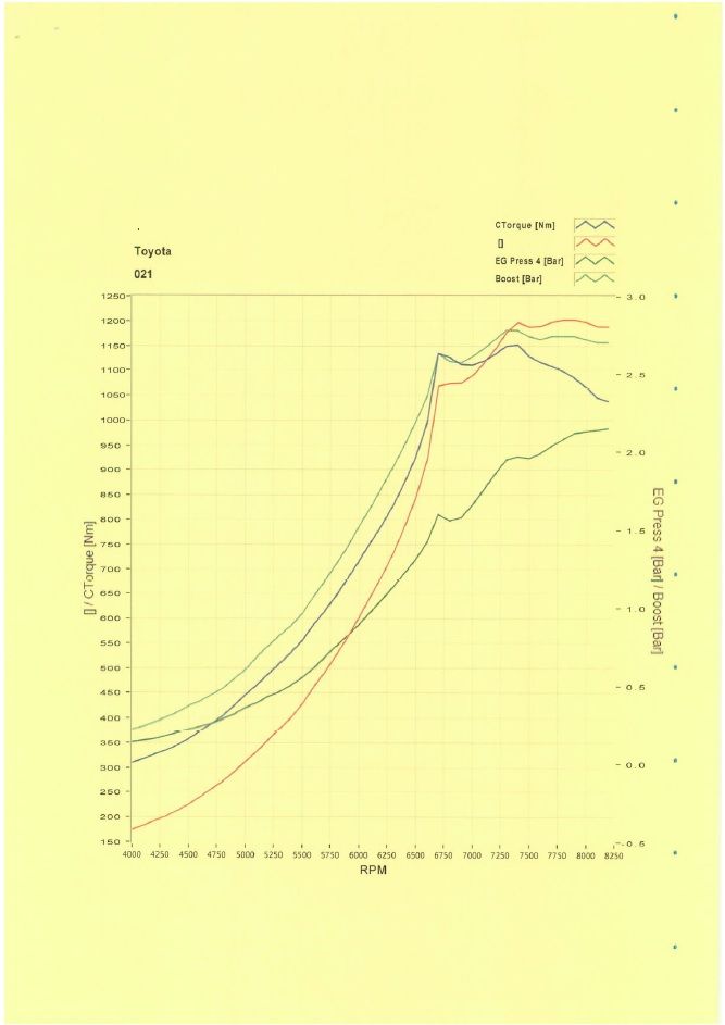

Hey,
Thought you guys might be interested of my friends 7M engine dyno. :)
1201hp / 810 ft.lbs @ 38psi
7M-GTE
8.5:1 pistons
Eagle rods (yes, they are on the edge)
HKS Stopper gasket
ACL bearings
Ported head + custom cams
80mm Holset turbo
Custom made manifolds
E85
[video=youtube;yB0vznfnJtI]https://www.youtube.com/watch?v=yB0vznfnJtI[/video]
The oil from the catch can is being sorted, better crank case ventilation is being built.
Dyno sheets:

I'll be interested to see what the final numbers are bolted in the car on an actual dyno. Engine dyno numbers are incredibly inaccurate, all you know for sure is that it makes a lot.
